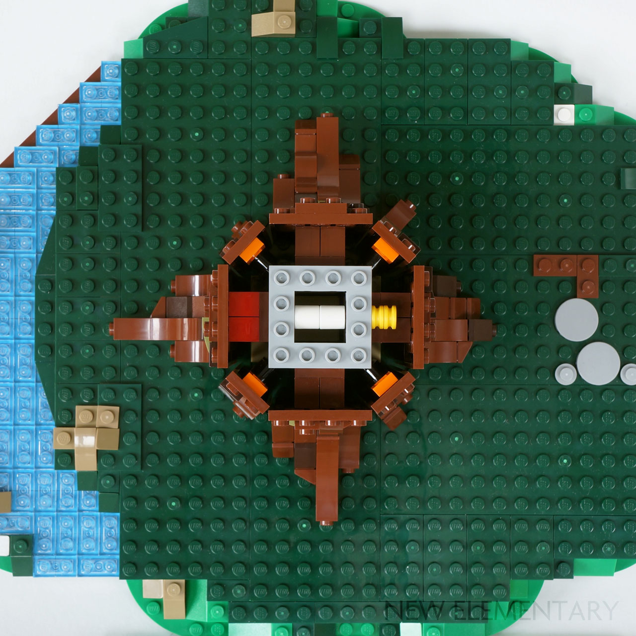

The aforementioned base is constructed from a Technic frame sandwiched within layers of plate. A single Technic beam rises vertically to attach the trunk. It puzzled me that, in order to secure the red 2x2 plates with 2 studs, the 1x4 tiles are placed over the stud-free area of the red plates. I wonder if they found they needed a little lee-way to allow for movement of the trunk in the finished model, i.e. maybe the red piece was originally regular plate but was under too much stress when secured completely? Anyone have any other ideas?
I anticipated the trunk being Technic as well, for strength, but its core is instead constructed of System parts including large door frames, all cross-braced using sideways building.
One side is red for orientation; an important aspect throughout the instructions given the constant likelihood of attaching things to the wrong side. The outward-facing bricks are used to attach the larger sides of the tree.
You can also see in the picture above that Black 'Minecraft feet', Plate 1X2 W/ Vert. Tube
(Element ID 6250020| Design ID 41682), are used to attach the trunk to the base, although of course an axle is also threaded through the Technic beam.
Note too, the Black ‘espresso plates’, Plate 1X1 Round W/ Horizontal 3.2 Shaft (6196548|32828), along each of the four corner edges with their 3.18mm bars protruding.
They are included to attach four narrower plates at 45° via blue Technic half-pins, to create an octagon.
This technique continues upward, interrupted by the three strong branches that support the three cabins. Two of these branches project at the usual 90° angles but the other is off-grid; strongly supported by what seems a bizarre layer of seemingly random rounded parts until you connect the branch and it all makes sense.
As the trunk narrows, a more traditional 'Lowell Sphere' style of technique is employed instead but with the core interrupted by connections for the upper branches that will contain leaves, including some at 45°. To accommodate these protrusions, the plates applied sideways form an interesting bottle-like shape.
The build process is pleasing and not strictly repetitive – within the main trunk, there is literally only one instance of the dreaded "2x" callout warning you that you'll need to create a sub-build twice. Everything else is unique, although there are many similarities in each sub-build, which is comforting but doesn't allow you to switch your brain off because small differences in decoration and construction are always appearing.
Reading the instructions is a little harder than usual because of the sheer amount of Reddish Brown on Reddish Brown. Outlining new parts in each step might have helped, or at least having the Dark Brown elements outlined in white. I'm sure it will be fine for most people – I only notice this stuff nowadays as my eyesight is getting a lot worse!

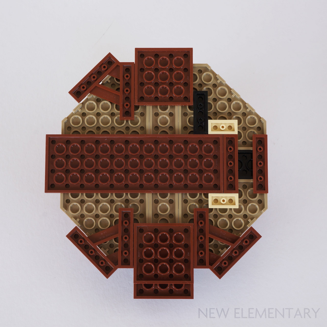

The cabins are octagonal, slightly wider along one dimension. It's nice to see the weird Plate (A) 4M 45° (Design ID 15706) used, to create the 1-module wide balcony on the angled sides.
It is now that the level of detail injected into this set truly becomes apparent. Here is the parents' bedroom under construction.
I particularly appreciated the logical thought that went into the plumbing in the bathroom, with an external water tank feeding a detailed shower, basin and the obligatory LEGO toilet – this time constructed of wood. Even the roll of toilet paper looks eco-friendly!
